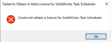

I’m getting the following error when trying to trying to call RunMacro API call:
Failed to Obtain A Valid License for SolidWorks Task Scheduler
Could not obtain a license for SolidWorks Task Scheduler.

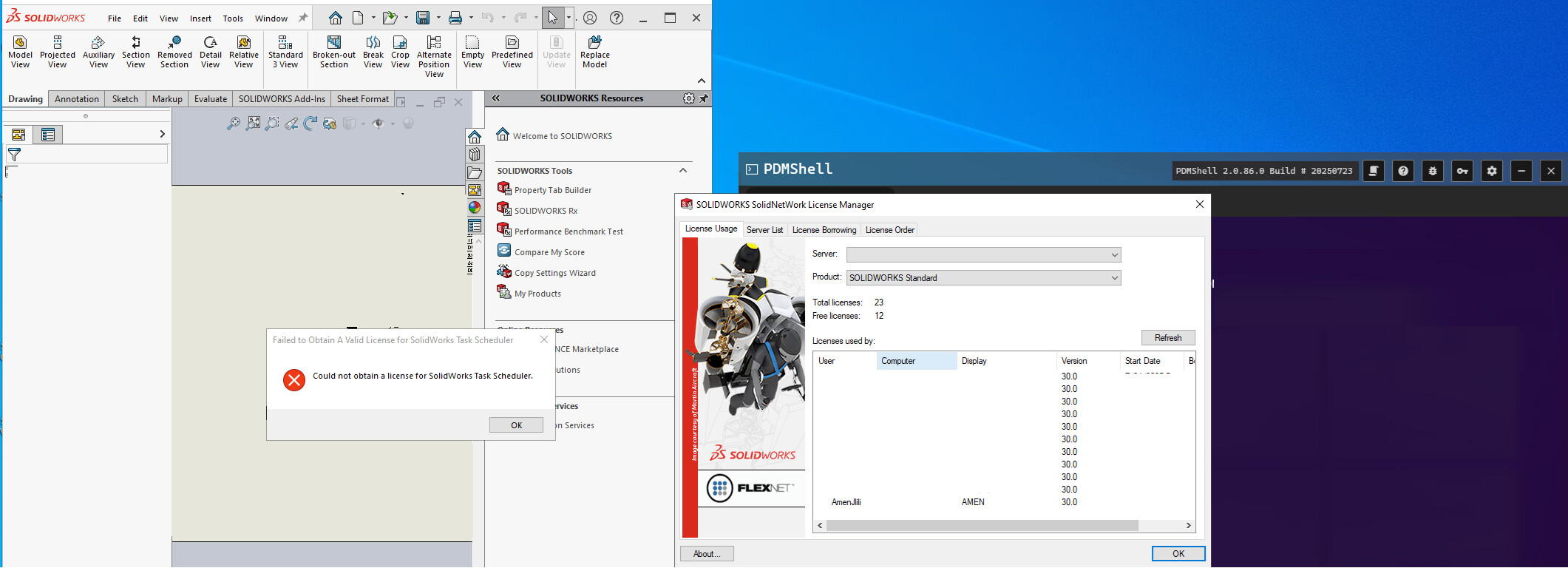

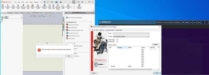

I will have to check this. It is a SW on a VM installed by a customer.
Updates:

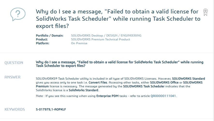

Found the issue. It does not matter what type of SOLIDWORKS Installation you have.
You need to make sure the license you have is a Professional or Premium.
This error will make the RunMacro2 API call fail.
