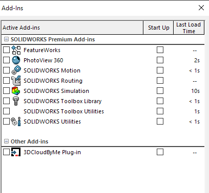

This code loads a SW window with no add-ins active. I was playing around with how to open a specific version of SW but both methods open an instance without add-ins. I’m not 100% sure why, but maybe this will help.
My issue with this approach is that the add-ins aren’t shown in the Tools → Add-Ins menu anymore. There are usually twice this number of add-ins to select.
