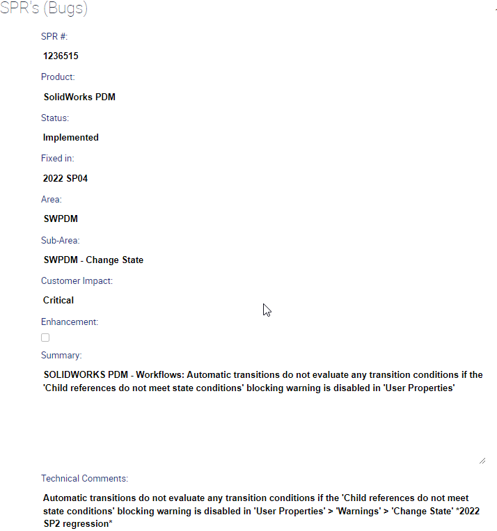

I Upgraded to 2022 SP2 and after the upgrade all my auto transitions ignore the conditions on existing Vaults.
Found this and it seems like what you’re experiencing
It makes it sound like enabling the warning will fix it
Yeah I saw that except it was doing ti to transitions without children conditions as well so.
Appears to be the same thing, ours is deselected for a reason. so this will be problematic, I didn’t realize it was evaluation with admin privileges. Even when it has no children still has the issue.
