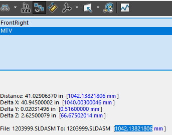

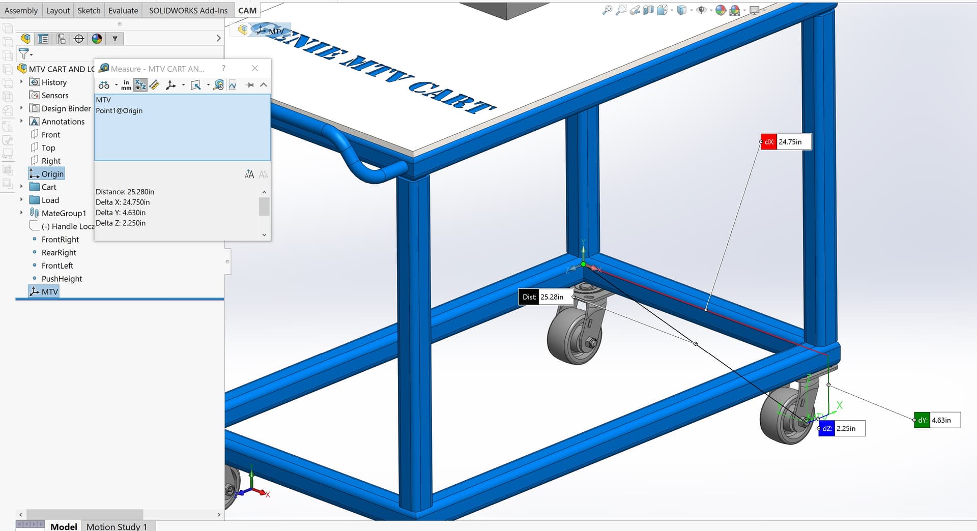

The reference coordinate system “MTV” is located at the point “FrontRight”, so the new XYZ values should be 0, 0, 0. Instead I am getting 0.05715, 0.62865, 24.867602.
Image of the Origin Coordinate System and the MTV Coordinate System:
