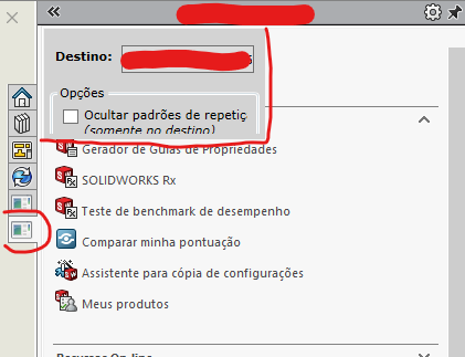

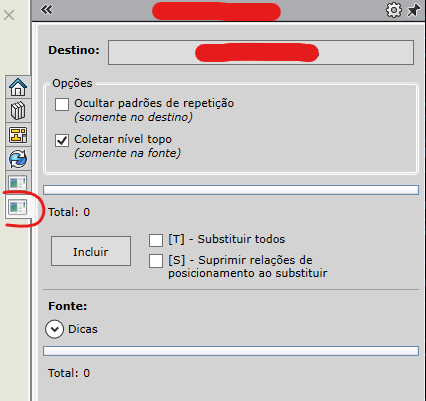

I’ve made a WPF form to be shown as a new task pane tab. The new tab is triggered by a button in the command bar and randomly is shown ok or “cropped”.
Good show:
Cropped show:

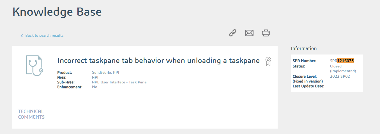

@PeterBrinkhuis : Would you be kind enough to list the SPR # for future folks having this issue? Thank you!
​Sure, I think it’s 1216073, which was supposedly fixed in SW2022 SP2. The text in the SPR is useless of course…
