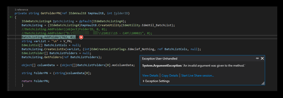

i completely do not understand why it happens…
i want to get folder variable value…
link to API help:
AddFolder Method (IEdmBatchListing) - 2021 - SOLIDWORKS API Help
void AddFolder(
System.object oIdOrPath,
System.int lParam,
System.int lEdmListFolderFlags
problem in System.int lEdmListFolderFlags. i need set to 0, not to 1(recursive folder content). but 0 do not work. only this is work:
BatchListing.AddFolder(FolderID, 0, Convert.ToInt32(EdmListFolderFlags.EdmListFolder_Recursive));
but i do not need folder content…
EdmListFolder_Nothing is not workable, when using it System.ArgumentException is appear…
is where a way to get value from folder variable? it seems to me that somewhere in the examples I have seen how this is done, but I can not find where…
korbn
September 27, 2021, 11:38am
and in visual studio, then typing this method:
says that the third parameter is not required, but the value 0 causes an error

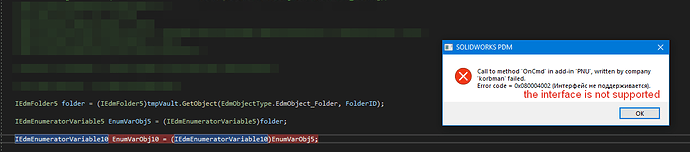

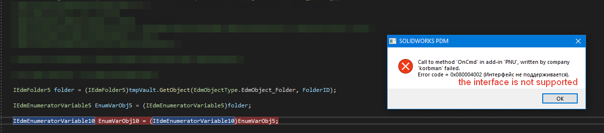

3
found this method: GetVar2 Method (IEdmEnumeratorVariable10) - 2021 - SOLIDWORKS API Help
in this API help about EnumVar IEdmEnumeratorVariable5 Interface - 2021 - SOLIDWORKS API Help
said:
IEdmEnumeratorVariableN interfaces on the following do not need calls to IEdmEnumeratorVariable8::CloseFile:
folders (cast IEdmFolder5 to this interface)
what i do wrong? because an error occurs “the interface is not supported”
private string GetFolderPN(ref IEdmVault5 tmpVault, int FolderID)
IEdmFolder5 folder = (IEdmFolder5)tmpVault.GetObject(EdmObjectType.EdmObject_Folder, FolderID);
IEdmEnumeratorVariable5 EnumVarObj5 = (IEdmEnumeratorVariable5)folder;
IEdmEnumeratorVariable10 EnumVarObj10 = (IEdmEnumeratorVariable10)EnumVarObj5;
object VarObj = null;
EnumVarObj10.GetVar2(V_DN, "", FolderID, out VarObj);
string CurrentDN = VarObj?.ToString();
return CurrentDN;
