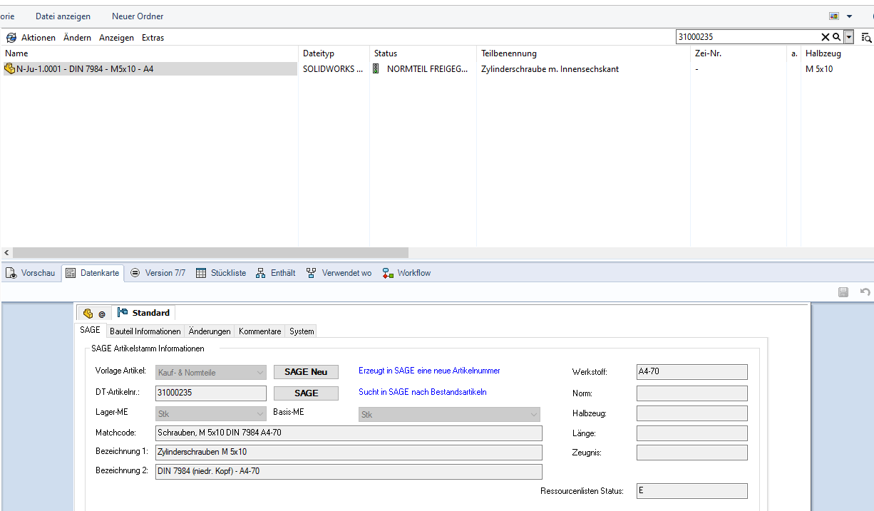

I don’t have the file name, i have a list of “article number” and need to find their file name and path. The PDM Search does it (see picture) but i need to make a lot of times so it’s why we want to write a macro doing it.
The code I wrote is a copy of one my boss made for an other application, and im quite a beginer in PDM api. The “search.FileName = DesiredFile” is i think wrong.
