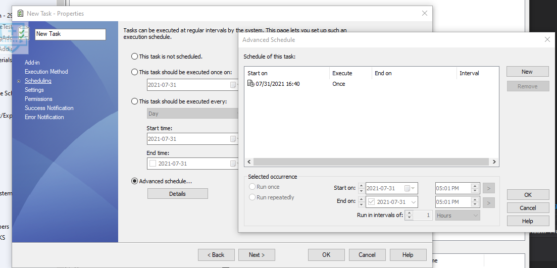

So everyone knows you can schedule task to run at specific time. Awesome feature. A lot of people would schedule tasks to run during non-business hours. This means the task launches and runs completely unattended.
This works fine if the task does not require user input but what if it does? The problem with the current architecture is that your TaskLaunch is only triggered when it’s time to launch the task.
I think SW should add a new hook called OnTaskSchedule where the user is able to provide the task with some input. This can take occur is the task is immediately scheduled and serve as a replacement for TaskLaunch.
When the task setup window loads you can cache the stored scheduling info to RAM. When you call TaskSetupButton you could then compare the newly entered data to RAM to see if it changed. If it did call a custom routine for input and store to a DataDictionary.
That is, if you can read scheduling data from the API… if not, you’d have to check the SQL tables programmatically to do this.
That’s a great approach. The only issue with this approach, if you don’t mind me saying, is that in order for you to add user input to the task, you need to edit the task definition. I don’t think the user that is launching the task is meant to do that (or needs to).
Adding logic to manage tasks in the task definition (via IEdmTaskProperties.SetValEx and GetValEx) is not something I want to do that. It kind of defeats the point of the task list.
I appreciate the feedback. I guess I am not familiar with a way to schedule a task outside of editing the task definition (to get to the scheduling page). So in my eyes, there really isn’t another option. But maybe I just didn’t know of other ways.

So the scheduling feature of the task does not allow for user input (apart from the Admin entries in the task setup page).
If you need a user to provide input, you could use a simple right click add-in menu to pop a GUI where they enter the relevant info. This is saved to a database (or data dictionary) that a scheduled task is monitoring periodically.
Anytime the scheduled task sees new updates to process it goes ahead to do those tasks.
