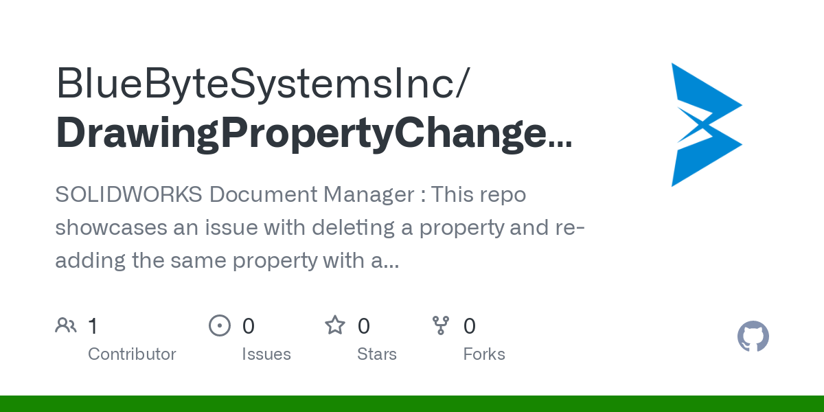

- Git clone the repo.
- Open sln in VS.
- Restore nuget packages.
- Make sure swdocumentmgr.dll Embed Interop Types = false
- Create a file called DocManKey.txt at the root of the solution and put your document key manager there (must be 2021 or newer)
- Inspect the Vendor Date property in the part and the drawing files. Files are at the root. Observe how the type of the Vendor date property is Date.
- Compile.
- Run.
- For both the part and drawing (from the debug folder), inspect the Vendor Date property in SW.
- Observe how the Vendor Property type for the part is text (which is true) and Date for the drawing (which is not the expected value).
Confirmed with my 2021 SP5.1 install.
