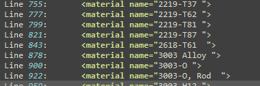

So after doing a lot of digging, I found that whoever created our materials in our custom database initially had unknowingly placed a space after almost every material, which explains why some worked and some did not. Now, since I didn’t change my add-in code it still seems odd that it worked and now it doesn’t, but I found the issue and it’s resolved.
