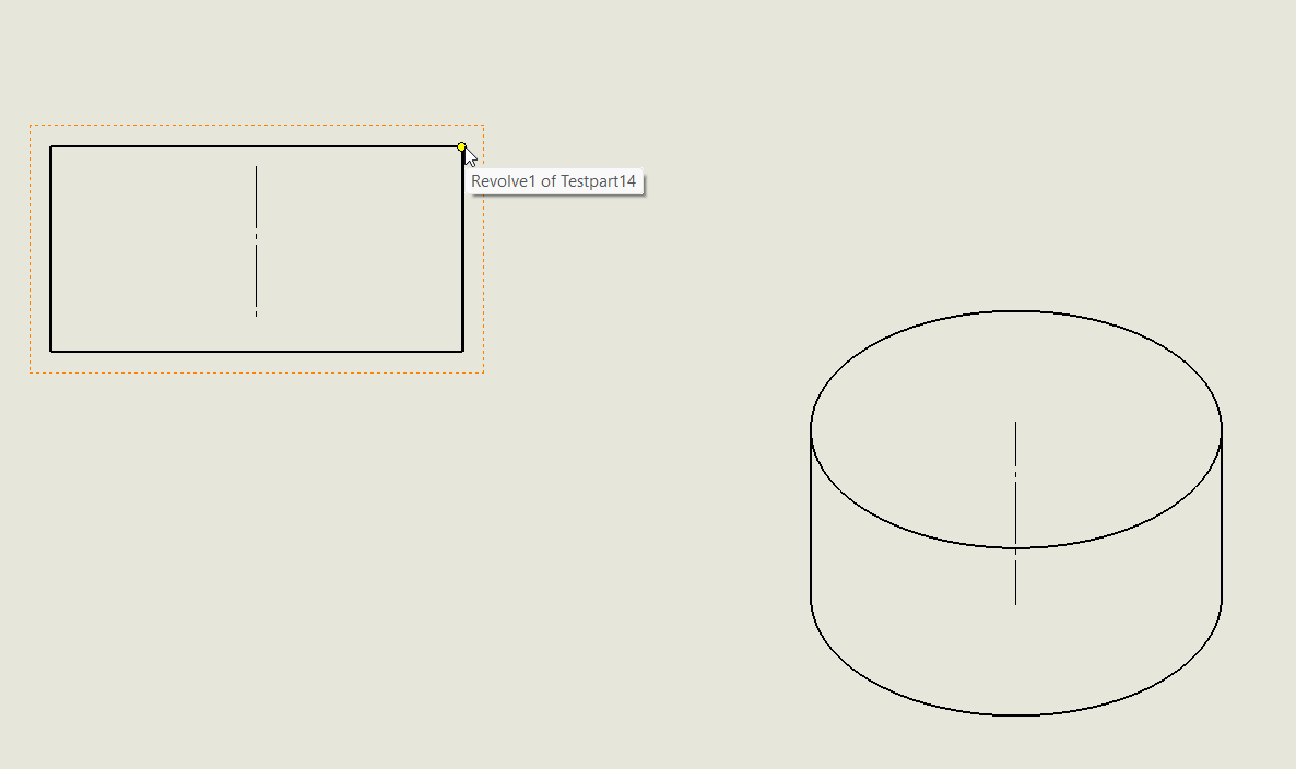

I have recorded the code for selecting a silhouette edge (or rather vertex) with the macro recorder. SW spit out the number 92 as the selection type. I searched for this object type in the documentation and also in the object browser, but found nothing.
Do you know what it stands for?

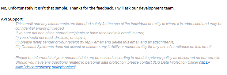

You are correct, this value is not documented. I suggest you send a feedback request from the API docs, Joyce will pick that up and ask the devs if necessary. They only fix the docs of the latest version, though.
here is the answer of SW:
