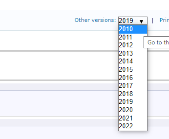

This enumeration goes back to 2010 on the selector in the corner so it’s been maintained/modified over the years. I’m guessing that it just happens to be used on the ModelDocExtension.SaveAs currently as well.
Edit: According to web archives, it looks like it’s been poorly documented from the beginning

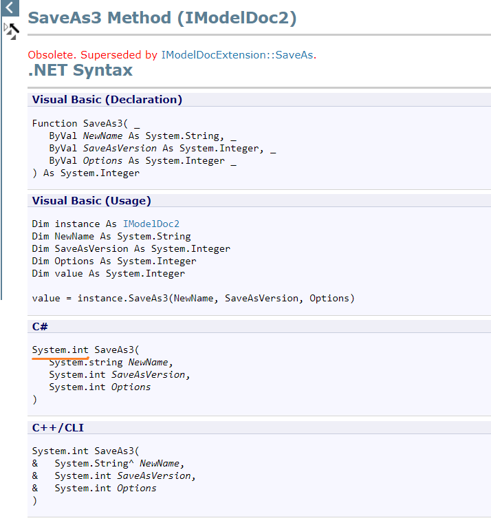

2015 snapshot:
https://web.archive.org/web/20151127020704/http://help.solidworks.com/2012/english/api/sldworksapi/solidworks.interop.sldworks~solidworks.interop.sldworks.imodeldoc2~saveas3.html
When SaveAs3 executes correclty, the retval is 0. I wonder why swFileSaveError does not have a default 0 member.
I suspect it returns HRESULT (i.e. S_OK for 0)
BTW. You can see all the API versions of the help back to 2010
