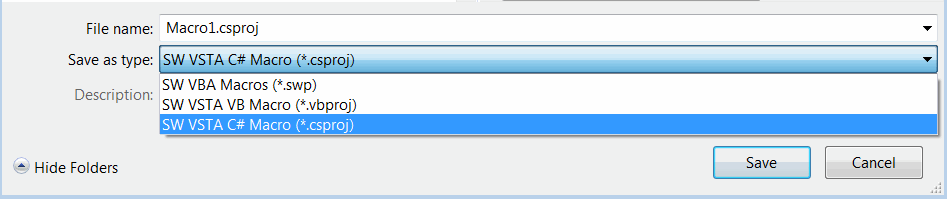

I am trying to develop addin via C# for Solidworks. The command in add in will run macro which is recorded via solidworks or typed by me. Is the macro must be .csproj format or can ı use .swp format. Solidworks cant record macro .csproj format and also ı cant implement my macro to C#
I am using Visual studio 2022. Here is the some source but ı didnt understand.

Sorry ı i’m so confused. Basically ı mean ı can’t record csproj format macro in solidworks eventhough ı installed Microsoft Visual Studio 2015

actually,the problem is that i cant save my macro as csproj ,.
(im using solidworks 2022 and i recently installed the visual studio 2022)
