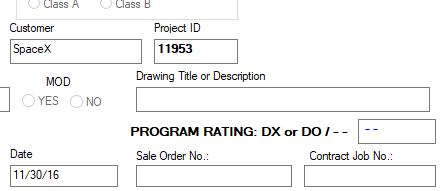

Your GetVariableValue() function is actually just getting a list of variable names linked to the card controls. So, you’re just returning the first variable linked on the first control on the card with return variablesList[0]
To get the value of the variable, you’ll need to use IEdmEnumeratorVariable5.GetVar2()
var enumVariable = aFile.GetEnumeratorVariable();
enumVariable.GetVar2(variableName, configName, parentFolderId, out object variableValue);
var variableValueAsString = variableValue as string;
example of data card format:
