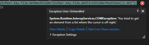

@AmenJlili
I’m getting an error with your folder ID method on some files. I had to modify my existing file with your logic and this is what I’m getting.
Are you handling errors with the folder ID to make sure your method isn’t exiting early?
Hmmm. No idea why you are getting that.
Few thoughts:
- Are the files in the root folder? If not, forget this.
- If you can replace that method with just the parent folder ID that you already have than you should be good.
- Check if prefer 32 bits in the project properties is checked if you are running it from a console. if It is checked, check it off.
I double checked the settings just to be sure.
- No files in the root folder
- I was running my method side by side with yours to obtain the parent folder ID. The method you’re using seemed to have an issue when the parent folder ID was 0. I did find out that this issue was caused by weld fillet features for some reason and works fine when you manually set the parent folder ID to 0.
- Prefer 32-bit is grayed out and cannot be selected.
