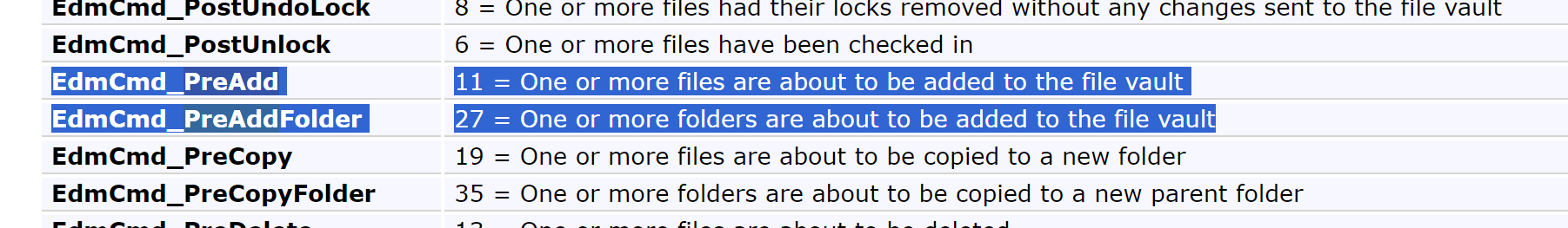

My bad. If you want to prevent files from being added to the vault from outside then you should look at the PreAdd Hook.
