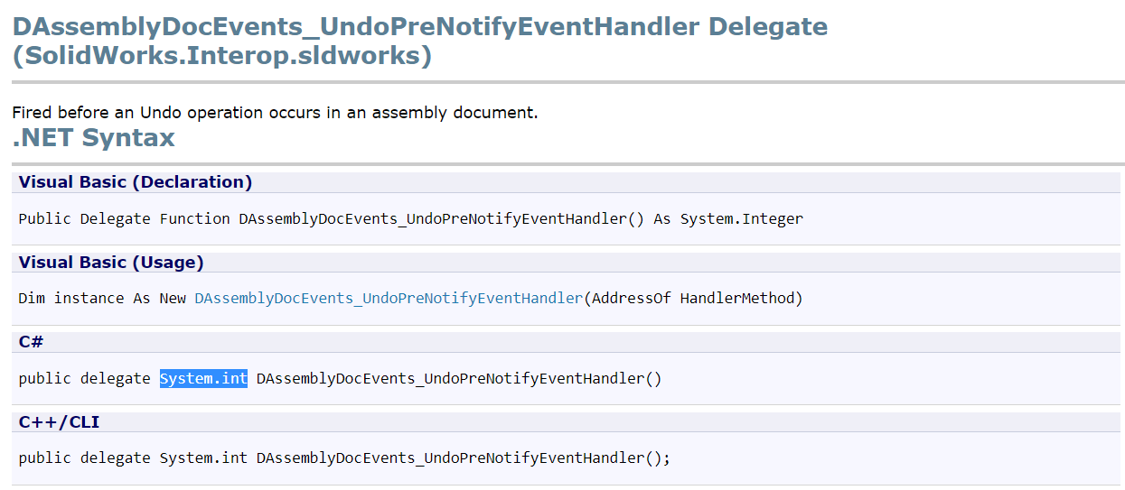

There are a few delegates in the SOLIDWORKS API that execute prior to an event. A lot of them are marked with the word Pre in the name of the delegate.
The delegates returns an integer. This leads to believe that returns 0, -1 or some sort of special value can set the event as handled (and consequently prevent SOLIDWORKS from carrying on the actual command).
I have tried to return 0 or -1 on the UndoPreNotify event. My goal here to prevent the user from undoing the previous command.
Returning those integer values has not yield the expected result so I’m wondering if I’m missing something here. I do think allowing us developer to have control over the event does present a security risk for SOLIDWORKS and hence why this might be disabled.
