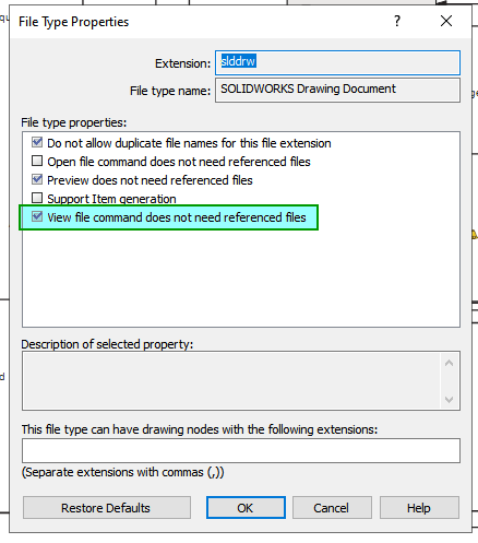

The longer we use PDM the more I see problems of wrong version being used, especially by people that don’t notice it. The Solidworks PDM add-in makes it more obvious which version is in use once the proper columns are added. When I consider non CAD users in other departments using eDrawings from a link in a notification email or double clicking a search result, they have no idea they’re looking at the wrong versions of the parts and eDrawings will not tell them. That case is most concerning as it gets more complicated to identify what’s going on because Solidworks will rebuild (or try to) on open; I just don’t know what type of updating eDrawings will do when the versions of components in local cache are different than when the drawing or model was lasted saved on some other computer. Or does eDrawings show an assembly without accessing the part files, even if they are in local cache? Note, we have the View File setting for the solidworks file types to not cache references; but that only applies when they right click “view file” if eDrawings is set as default program then links in notification emails and double clicking will still get latest of referenced files that are not in cache and will cause different behavior.

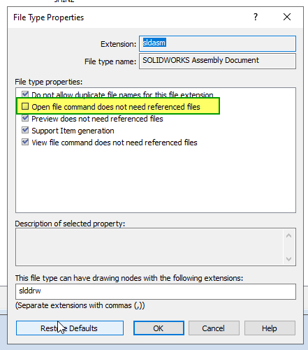

I might have found how to turn off automatically get latest while I was working on another task. Not saying I’m ready to check this box just yet, but it is in my mind to test behavior. If this were checked for the Solidworks file types then a PDM addin hook to the EdmCmd_PreGet command (I’m not seeing a PreOpen command) that would get referenced files by version.
