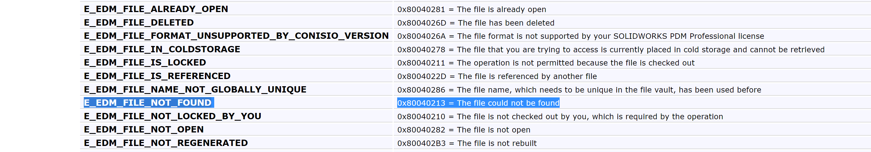

Anyone run into this in PDM when creating an automated step file?
E_EDM_FILE_NOT_FOUND

Thanks @BigCrazyAl, maybe it is, since its being triggered through a work flow, and its being processed on a different computer than the one triggering it, it doesn’t seem to stop it from working but it is still throwing an error.
the task host is signed in as admin, but maybe it isn’t pulling the files quick enough before converting it or something.
is this the convert task?
Yes it is the convert task
You’re having this issue because PDM is failing to add the file to the vault for some reason. I can’t really tell without looking at the code and or the workflow.
Does the error give you at least the file name in the local cache?
Its just weird because it has the warning but everything works fine. plus the task host is logged in as Admin so it shouldnt have any issues. its just odd.
