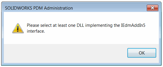

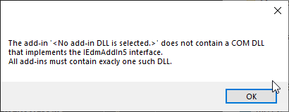

i tried this Standalone Tool from Solidworks:
I have tried this with version 2022 SP 3.1, but I always get the message:
It seems that the path is not being read correctly. Does anyone else have this problem?

What kind of add-in are you attempting to add? It looks like it’s having trouble verifying that your DLL implements the IEdmAddIn5 class. I believe I’ve run into this before but I can’t remember exactly what caused it.
Not sure what else to check at the moment but those should give you a good start.

There is a billion thing that could trigger that. It’s mainly because there is no dll in the file selection you made that implements the IEdmAddin5 interface.

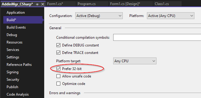

In your properties of the AddinMgr_CSharp project, un-check Prefer 32-bit.
This allowed me to install your add-in
ah i had to to this in this Project. This works now! Thank you very much
