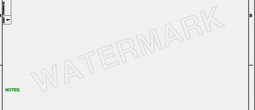

Another option that we use is a much more custom solution. I put something together in c# that applies a stamp to the corner of the drawing for our internal needs. It uses PdfSharp to manipulate the PDF document. This isn’t the same thing as one of the stamps within the Adobe software though. It essentially adds text and shapes anywhere you specify. It can even modify the transparency (see the “Issued” stamp/border in the image below)
I then use a Dispatch script to monitor if a file has changed state (has been added to the vault) and is a PDF file. It checks out the file, runs my stamping program, then checks the file back in.
