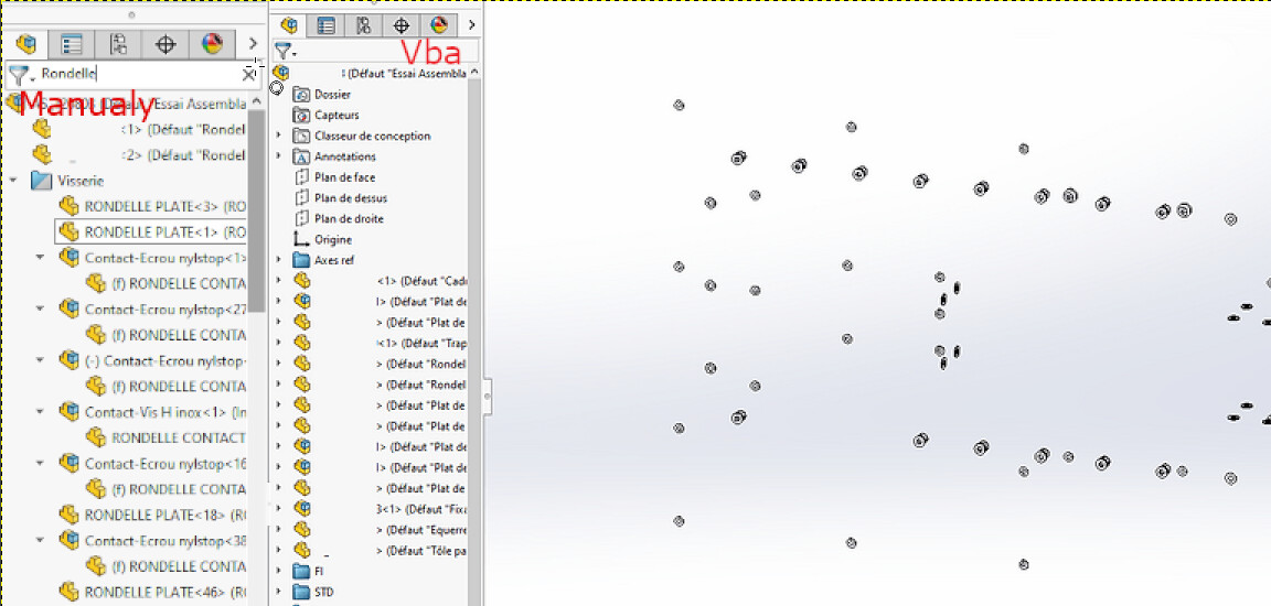

I’m trying to make a filter in vba (code below), but the compression is different from the manual input method.

With the Vba method, the 3D graphics part is filtered, but not the FeatureManagerTree part and no value in the filter is displayed.
With the manual method, the 3D part and the FeatureManagerTree are well filtered.:
2 problems :
differents between the manual method and the Vba method. (Bug?)
Slowness in clearing the filter.

Did you tried to find out the specific command of the text input field? Maybe there is a difference to the FeatureManagerFilterString… but to be honest - I guess it’s a bug
I also guess, it’s a bug
Thanks @Marcel, I’ve tried the 2 methods (Macro and Spy++), they work for other commands but not for this filter unfortunately.
Les 2 solutions proposés par code stack semble échouer pour ce filtre.
Unless I’m doing it wrong, perhaps, but no capture is made when an entry is made in this filter.
