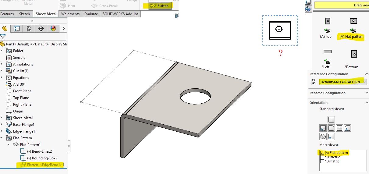

  1. I am think that ı couldn’t classify view count.Its sometime getting error while nesting view. That’s why am getting error.
  2. As ı typed below ı can’t get flatten pattern view in some part couldn’t. I have to unsuppress flatten.

If your flat pattern macro works on some models but not on all, I suspect that the model is to blame. If an engineer starts messing with the flat pattern configuration and suppresses the wrong feature, it may mess up your models.
The code you posted there only suppresses and unsuppresses features. It does not export anything yet. Are you aware of that? You may also have to suppress a flat pattern feature before unsuppressing the next flat pattern.

Thank for you reply ı solve it. 1. iteration problem 2. feature problem.( you can see in 3DX).

Here is the my second question answer;
searchStr = “Flatten”
Action = “Unsuppress” 'Change to “Unsuppress” to unsuppress supressed features
Dim swFeature As SldWorks.Feature
Dim swModelDocExt As SldWorks.ModelDocExtension
Dim featureName As String
Dim supstatus As Boolean
Dim j As Long
j = 1
Set swFeature = swModel.FirstFeature
Do While Not swFeature Is Nothing
’ Get the name of the feature
Let featureName = “Flatten-<EdgeBend” & j & “>1”
If InStr(1, featureName, searchStr, 1) Then
’ Select the feature
supstatus = swModel.Extension.SelectByID2(featureName, “BODYFEATURE”, 0, 0, 0, False, 0, Nothing, 0)
If (Action = “Suppress”) Then
supstatus = swModel.EditSuppress2() ’ Suppress the feature
ElseIf (Action = “Unsuppress”) Then ’
supstatus = swModel.EditUnsuppress2() ’ Unsuppress the feature
End If
End If
Set swFeature = swFeature.GetNextFeature() ’ Get the next feature
j = j + 1
Loop
