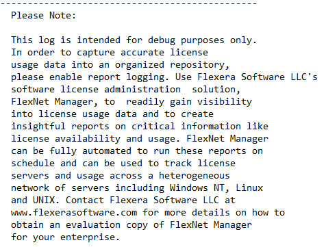

The license server keeps a log, but it’s not exactly meant for running reports. At the top of the log, they placed this message:
So, it’s possible but it sounds like it will also cost more money.
