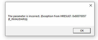

Hi I got issue with getting latest version of PDM files.
I have not complete the codes but even half way I got errors.
Could you please any one help on this?
I did replace “VaultName” with my vault name.
Thanks.

This is the exact line I’m getting an error while putting the breakpoint.
pdmBatchGetUtil.AddSelection((EdmVault5)pdmVault, ref ppoSelection);

Yes. Stack trace please.
At that particular line, stack trace is empty while getting error.
