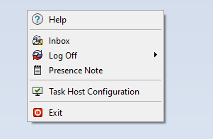

Anyone know an efficient way to permit add-ins from the task host configuration without using the UI?
