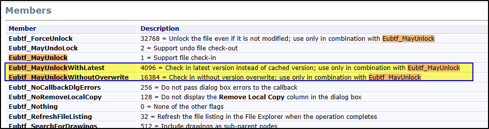

I have not tested this but 4096 might be what you want; the terminology between API and GUI is often different for similar things. I intentionally avoid having anything I write check a file in with version overwrite. I know so little of the entirety of PDM that I don’t want to loose the ability to go back to previous version.

now only Eubtf_MayUnlock
tried:
Eubtf_MayUnlock + Eubtf_MayUnlockWithLatest
Eubtf_Nothing
Eubtf_MayUnlock + Eubtf_MayUnlockWithoutOverwrite
and there is always a new version…
