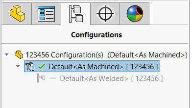

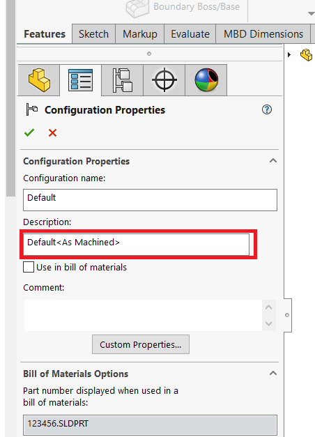

I have this odd behavior where IConfiguration::Name is returning something different than the actual name of the configuration. It is returning the description. Anyone has this issue before?
This is a tricky one. You have 2 Default configurations here, so those cannot be named default. But I remember being confused by this as well as I think Doc Mgr and SW treat this differently and one recognize this as Default configuration while other is as Default

@AmenJlili, Not sure whether it will help or not but you only see “As Machined” and “As Welded” notations for part that have weldment feature in it or created earlier. Configuration names still stay that way even if weldment feature is deleted so hard to find out whether the part is a weldment part or not.
