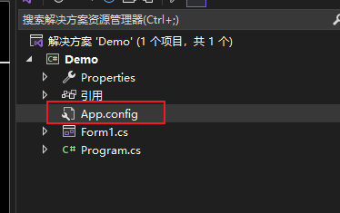

app.config is a good option
HI! I'm a bit of a noob: is app.config an option in a class library?
Yes it is an option in a class library
