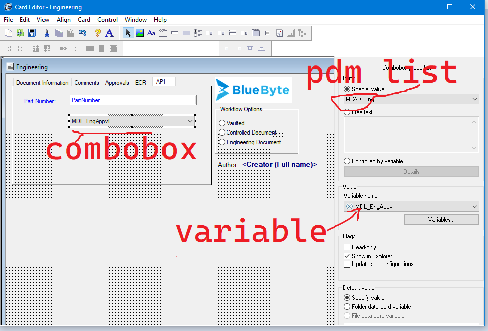

I’m trying to get the possible values for a variable that is linked a PDM list. Here’s a visual from my data card to explain the situation.
Here’s a snippet on how to do this in C#. One observation is if the list is grabbing data from a SQL server, the code might be slow to execute.
