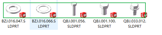

  1. I use SaveBMP()
    SaveBMP Method (IModelDoc2) - 2019 - SOLIDWORKS API Help
  2. Get images of files in a folder
