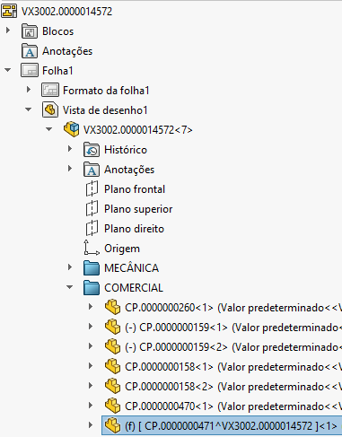

I’ve been trying to get the custom properties from a virtual component (fig. 1) for further adding as a text note in the sheet or view but the SelectionMgr::GetSelectedObjectsComponent4 only returns the root DrawingComponent class related to the view.
It’s possible to get the virtual component from the DrawingComponent::GetChildren array result but it isn’t the intended goal.
Figure #1 (virtual component selected at feature manager)
I though that GetSelectedComponentType3 would return a Feature, but it returns Component. But then you use GetSelectedObject6 and try to cast it to a Component, it doesn’t work. Casting it to a DrawingComponent does work, so then you get the underlying Component property and that’s the one you are looking for.
