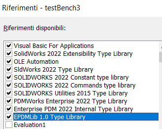

In VBE I added the reference to the PDM library:
SLDWORKS_nDYfK0ieD2
