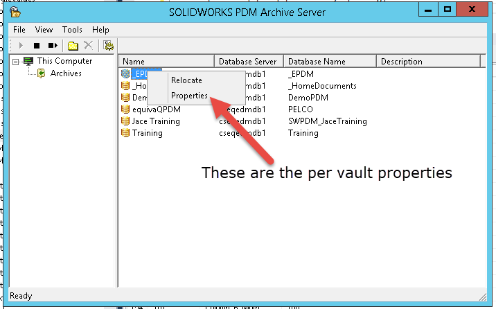

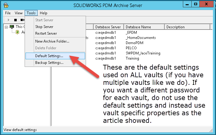

The article Amen shared is the exact answer you are needing. Keep in mind, PDM was designed to support multiple vaults so administrators can manage all vault admin accounts from one window using the PDM Archive Server Configuration Tool mentioned in the article so if you have multiple vaults, please consider changing the admin password using the default settings rather than vault specific properties.
