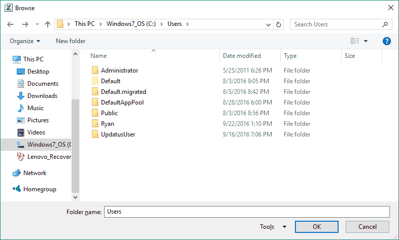

I’m looking for the complete VBA code of the new Windows folder picker (Not to be confused with the ugly and hardly to use Browse To Folder dialog).
Preference towards no references, no Excel dependency, and 64x support. I swear I came across this large piece of Windows API calls before…

Trying this example in SW shows the Open File Dialog instead of the Folder Picker.
I also initially pasted the wrong screenshot of the folder picker. Apologies.
