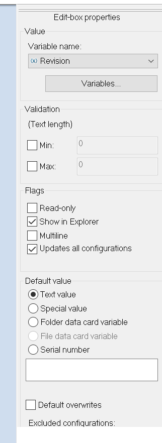

I’m working on a tool to pull custom property information from PDF’s via the PDM REST API. I have set up my part and drawing templates to do what I would like, but I am having issues with the “Save As” PDF function which does NOT drop in the latest Revision into the data card.
Our current workflow when finishing a part drawing is to save the drawing as a PDF with the a schema of:
“partNum (REV X).pdf”
Moving forward, I want to add that RevisionNum into the data card, and go back to all existing drawings to do the same via macro/automation.
I’d rather not use a macro for PDF creation on new parts as it seems that this type of information should be pulled in automatically from the revision table, but maybe I’m not setting my variables up correctly for the data card. Does anyone have any experience with this?
Below is a screenshot of my variable setup in PDM.
