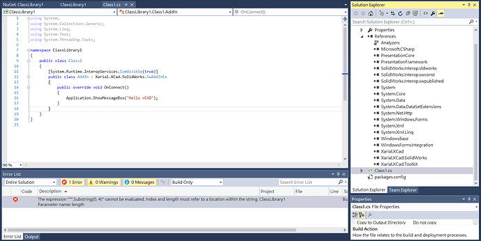

Hi Everyone, I am a newbie to C#

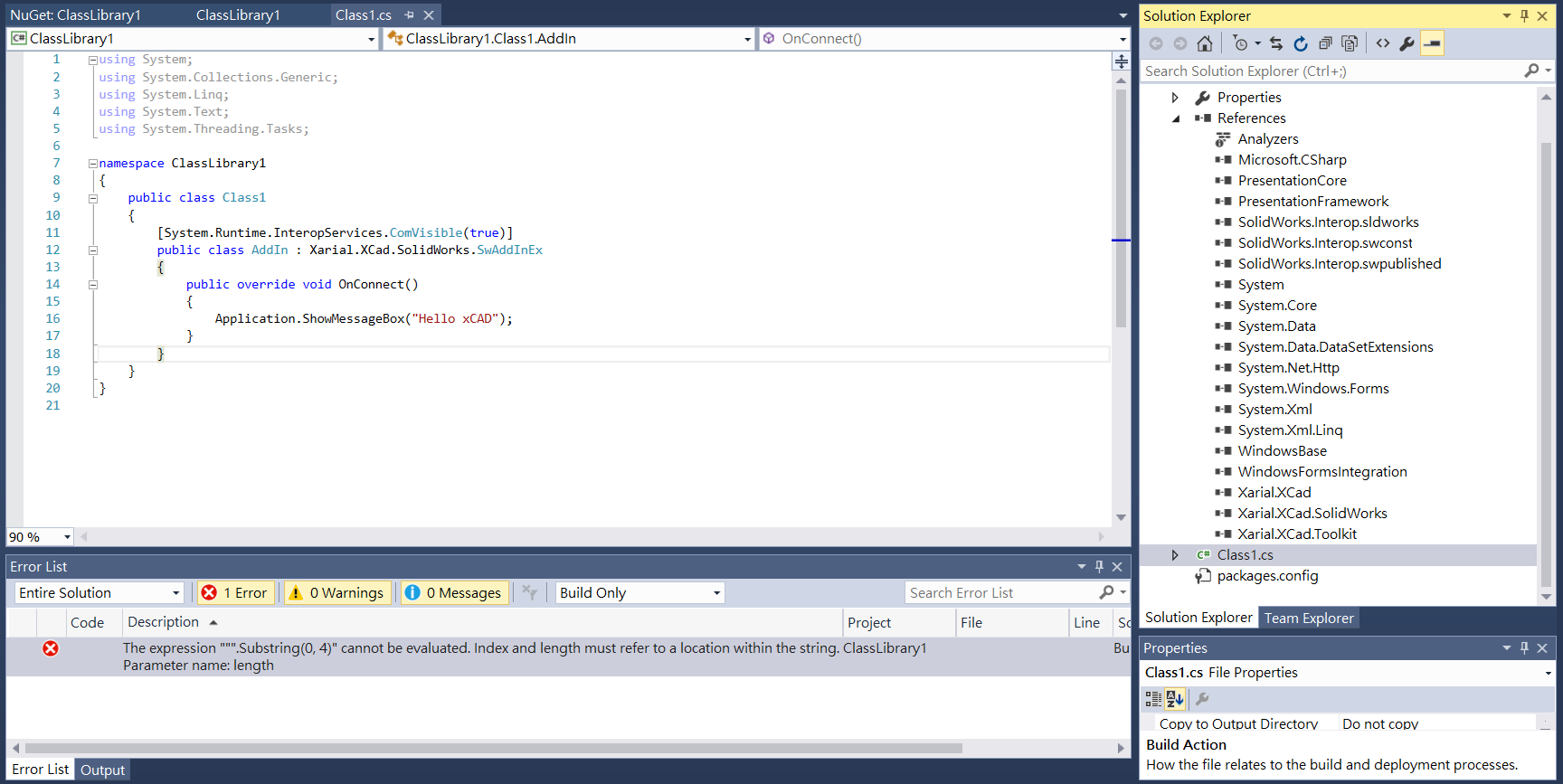

I follow XCad instructions to try to open a customize command manager tab in SolidWorks.
However, it keeps popping up an error:
“The expression .Substring(0, 4) cannot be evaluated. Index and length must refer to a location within the string. Parameter name: length”
As no line and code for this error, I have totally no idea how to solve it.
Could anyone help?

@Ryan, do you have this during the compilation, i.e. in the Visual Studio or at runtime? I can see Substring(0, X) is used once in the code to extract the version of the file which I believe is not the case here.
And it is also used in the project targets to extract the current version of the framework. And I believe later one is the case. If so, please make sure you are using either .NET Framework or .NET Core , .NET 5 is not supported yet as per this ticket. My recommendation to use .NET Framework instead of .NET Core for SOLIDWORKS add-ins.
@artem
I am using Visual Studio to code (Community 2015)
using .NET Framework 4.6.1 currently,

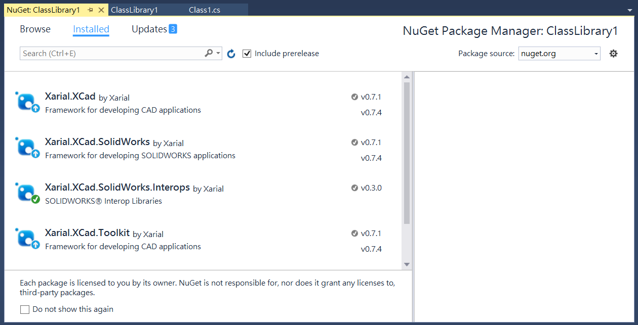

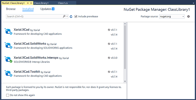

and these are the Nuget package I have downloaded and used as Reference
this time I am using a simpler code captured on Xcad platform,
but seems the same problem happen…

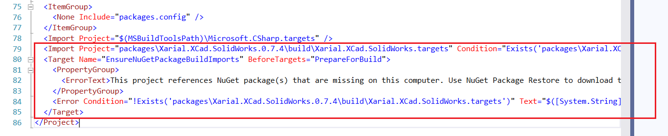

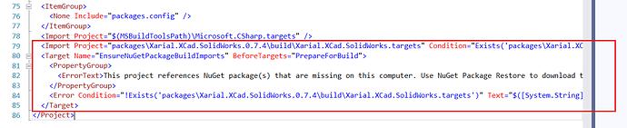

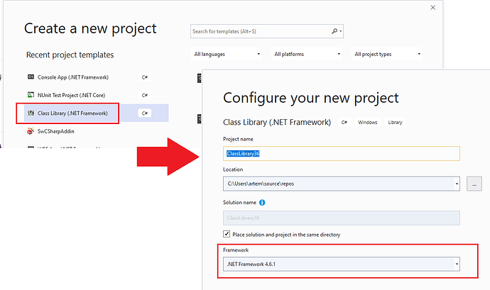

Ah, I see. Visual Studio 2015 is quite old and I believe has a different structure (could you please attach this .csproj file here so I can inspect it) - I am using 2019 Community. I think you can make it work in a slightly different way:
  • Unload the project and edit content (alternatively just open your *.csproj file in the notepad)
  • Remove the following portion from the project:
  • Now you need to add this into your postbuild events

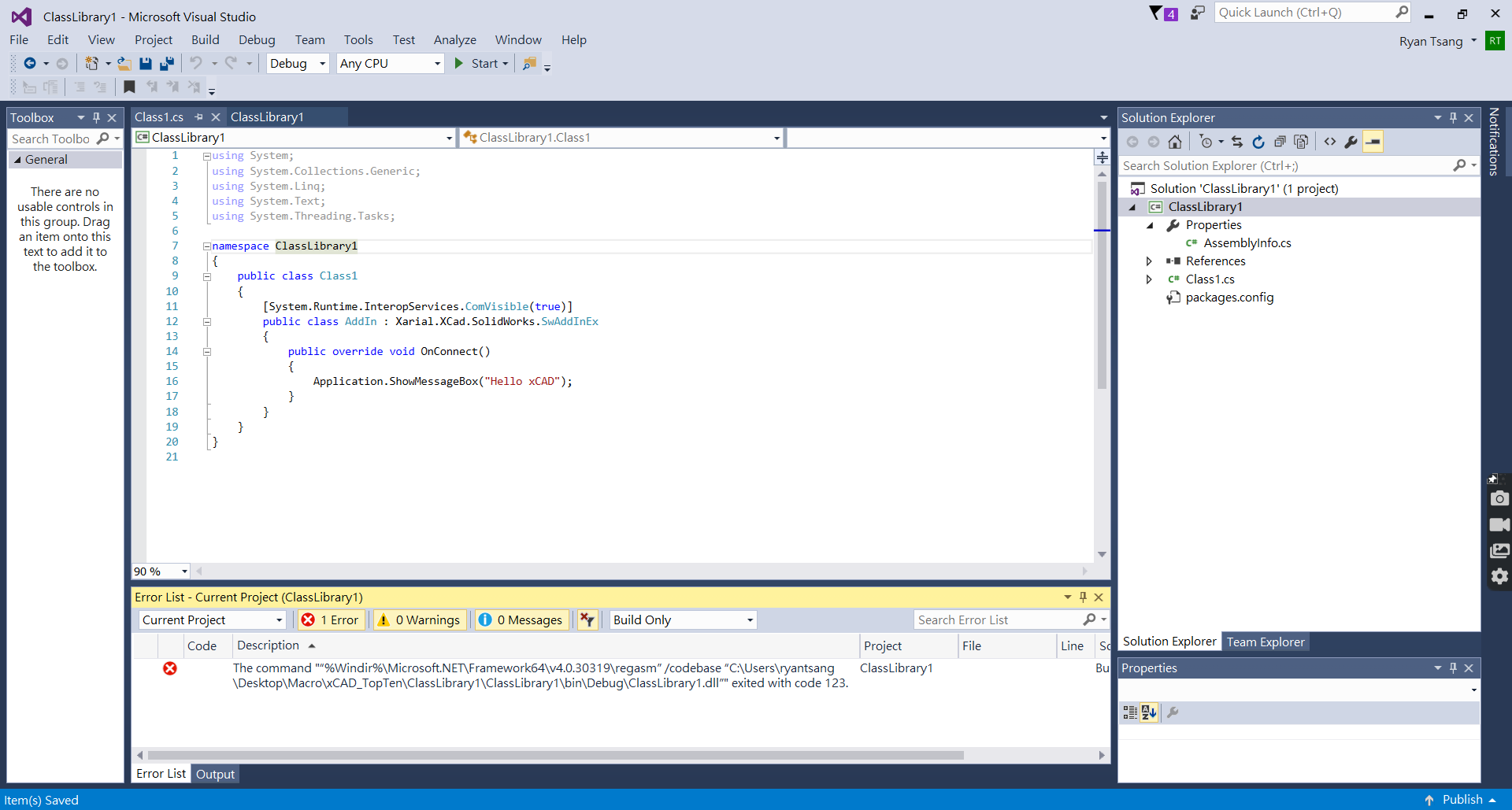

“%Windir%\Microsoft.NET\Framework64\v4.0.30319\regasm” /codebase “$(TargetPath)”
Thanks @artem
Another error message pop up after following above instruction
Here are the files:
https://drive.google.com/drive/folders/1zcZHID51JiL0bys7MdzPnASDdHi6D22d?usp=sharing

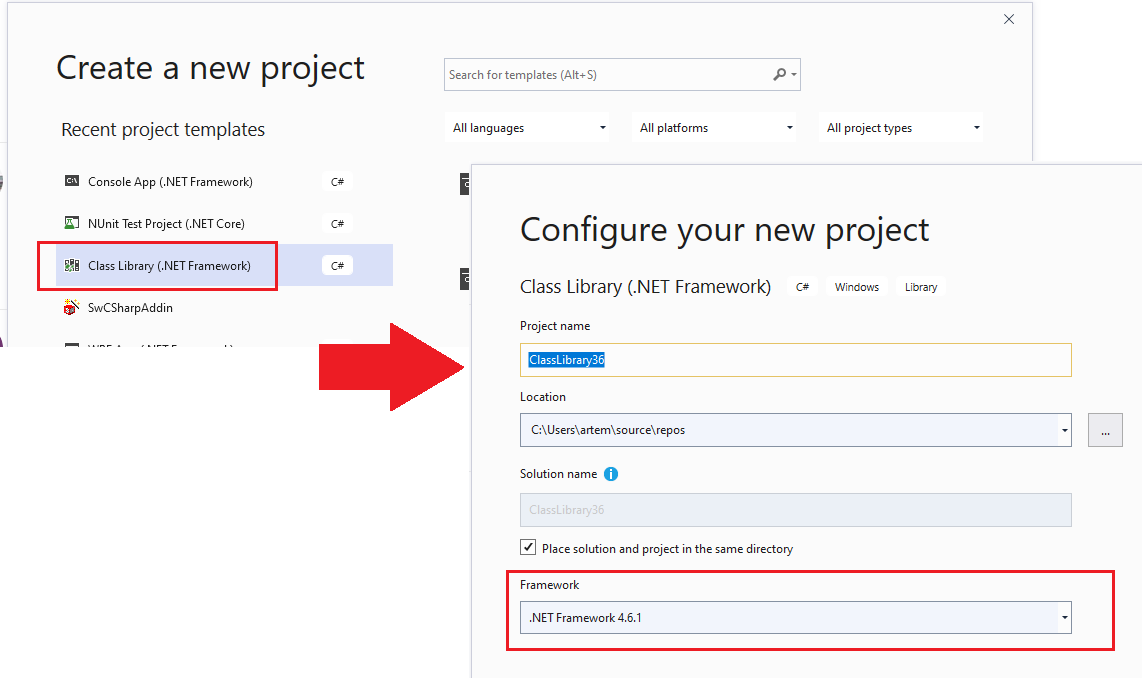

Is there a specific reason why you have to use VS 2015?
If not I would recommend to follow the flow and use VS2019, which is actively used for development/testing.

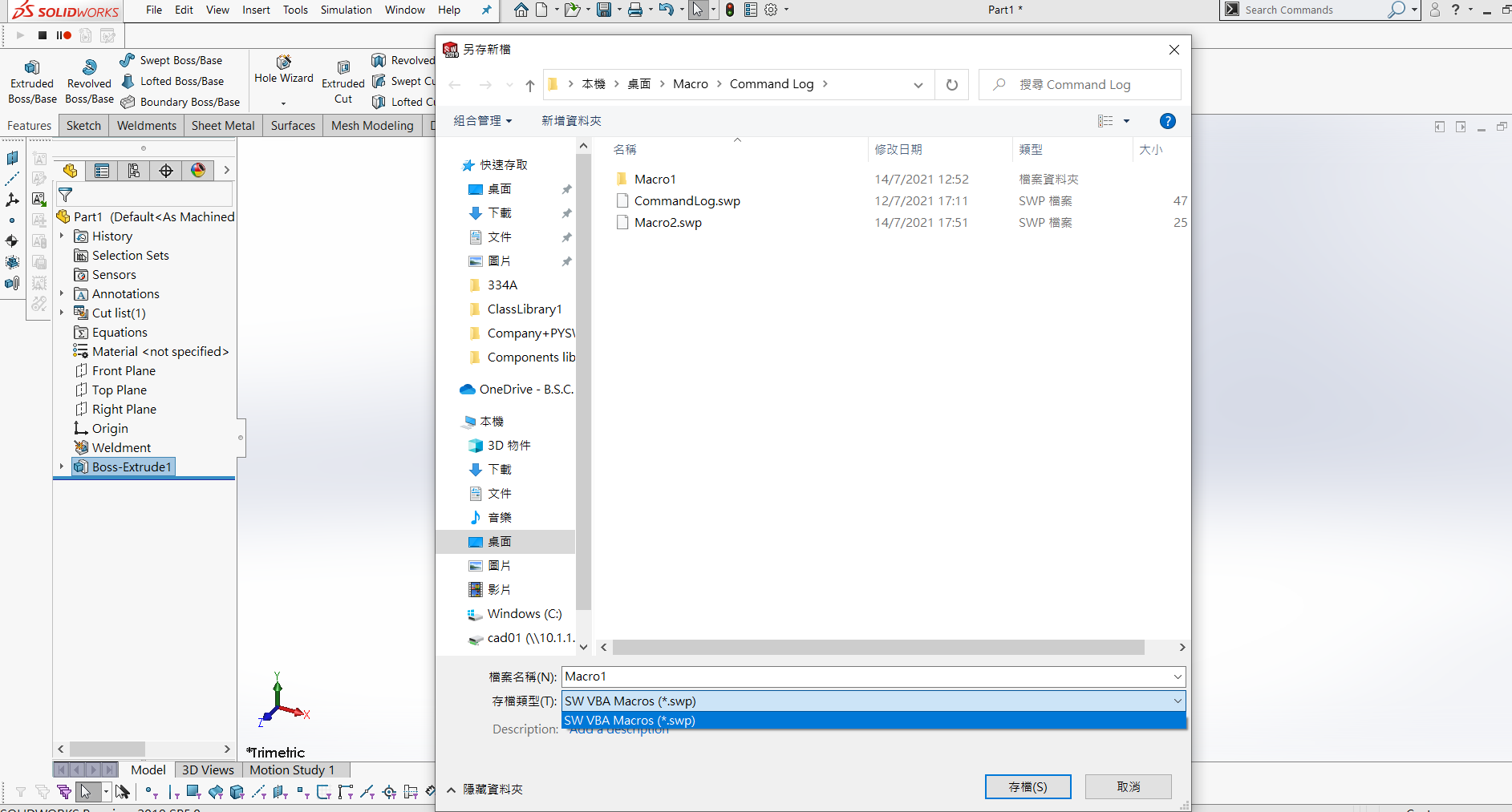

I try using 2019 at the beginning but not even work in recording VSTA macro in SolidWorks…
would reinstall SW and VS 2019 and try again tonight.

Hi Ryan,
I tested the VSTA macro recording after a long time of not using it and it opened up in VS2015 automatically.
Solidworks 2021 + VS2015 + VS2019 installed
I also had installed Microsoft Visual Studio 2005 Tools for Applications which was opening the macro in older times (VSTA 2.0 only if I remember correctly). VS2015 took over apparently.
Solidworks 2020 does the same: opening the macro in VS2015. But I had to switch on the option:
Enable VSTA Version 3.0.
Maybe you should do that also in 2019 ?
Eddy
Hi @Eddy , here is the case and that’s why I am using VS 2015:
what I just done is uninstall VS 2015 and SolidWorks
then have a clean installation for VS 2019 and the VSTA Tools
then install SolidWorks 2019 again
and click the Enable VSTA Version 3.0.
and…not even the VSTA macro option pops up
