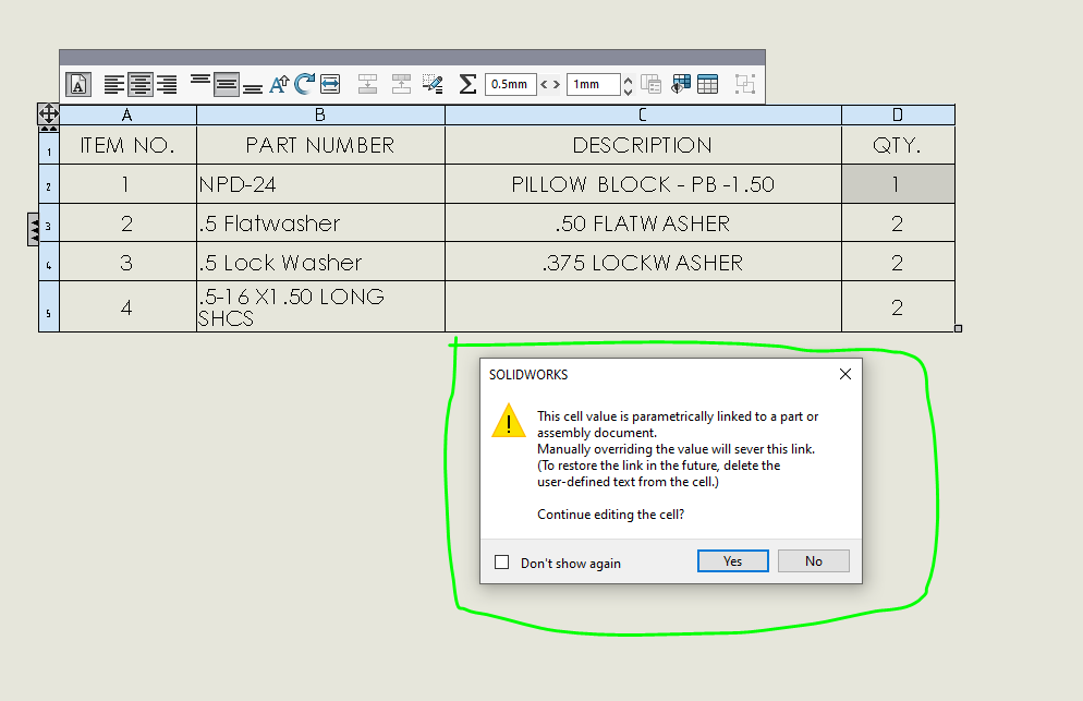

I thought so, but It’s not letting us. unless you cant in Computed BOMs
You must have set the option for this window “Don’t show again” and then clicked on No.
Go to Tools > Options > Messages/Errors/Warnings, select the message shown in above picture and click OK. Now you should be able to edit the qty value in the BOM.
