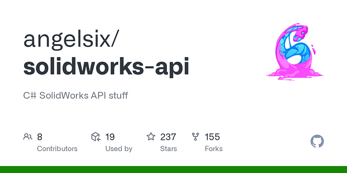

So I have finally, after a year of preventing myself to do so, forked the entire thing yesterday:
I have already applied all of my proposed bug fixes that were sitting in PRs. Then I’ll get the thing on NuGet, rework it for multiple add-ins and quite possibly remove the separate app domain option.
