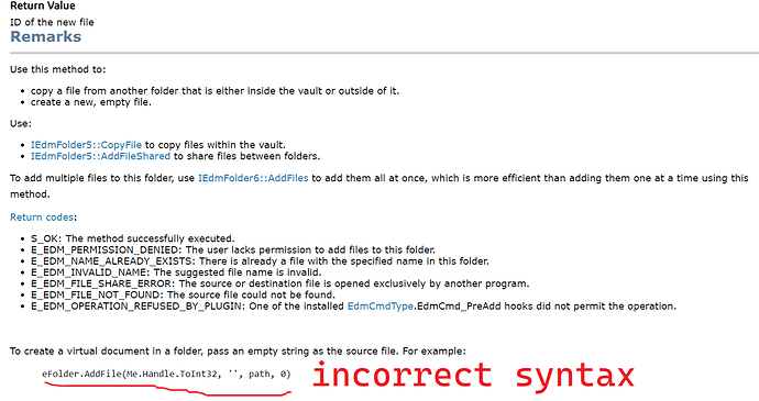

Came across this when I was working on a project where I needed to test setting variables for thousands files. The method AddFiles is what the API recommends for creating files in batch mode which is blazingly fast compared to AddFile.
The API remarks section needs an update.
The missing note about AddFiles in the API help is that you have to create the virtual documents on disk as opposed to AddFile where you can pass an empty string for the source file.
Here’s an example:
