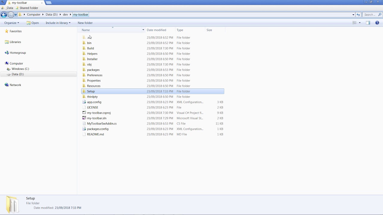

Yes, I’m doing the same with this method. Your AddInComReg.wxs file needs to be added to your Installer project after your build it for the first time from your separate library project. Have you done that yet?
Edit:
It will be placed in your build folder specified in your first quoted heat.exe line. On your installer project choose “Add → existing item” to your installer project and browse to the file.
The problem starts during generate AddInComReg.wxs this file not exist in my project or setup folder. I cant generate this file.
It works for me when I use your parameters. A “Setup” folder is created one level above the target build directory and contains the AddInComReg.wxs file.

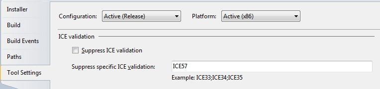

ICE57: Component ‘cmp8DF04E91C5D91A4BB4E451B62CBE9E85’ has both per-user and per-machine data with a per-machine KeyPath.

This sounds a bit more like a problem with the add-in project than with the actual installer. Without seeing the project as a whole, I don’t think I can be of much help.
