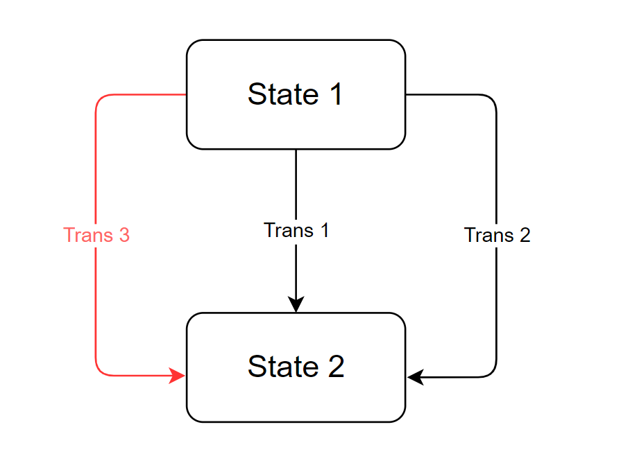

Im trying to move a file from one state to another using below code.
 oFile.ChangeState(toStateName, oFolder.ID, "Moved Programmatically", 0, EdmStateFlags.EdmState_Simple)
May I know which transition it will take and perform move? or is there any way to mention which transition it has to take and perform this action?
I noticed “ChangeState3 Method (IEdmFile13)” has option to mention transition. But it requires password which is weird.
Any idea how to move state by particular transition without password.
Thanks
