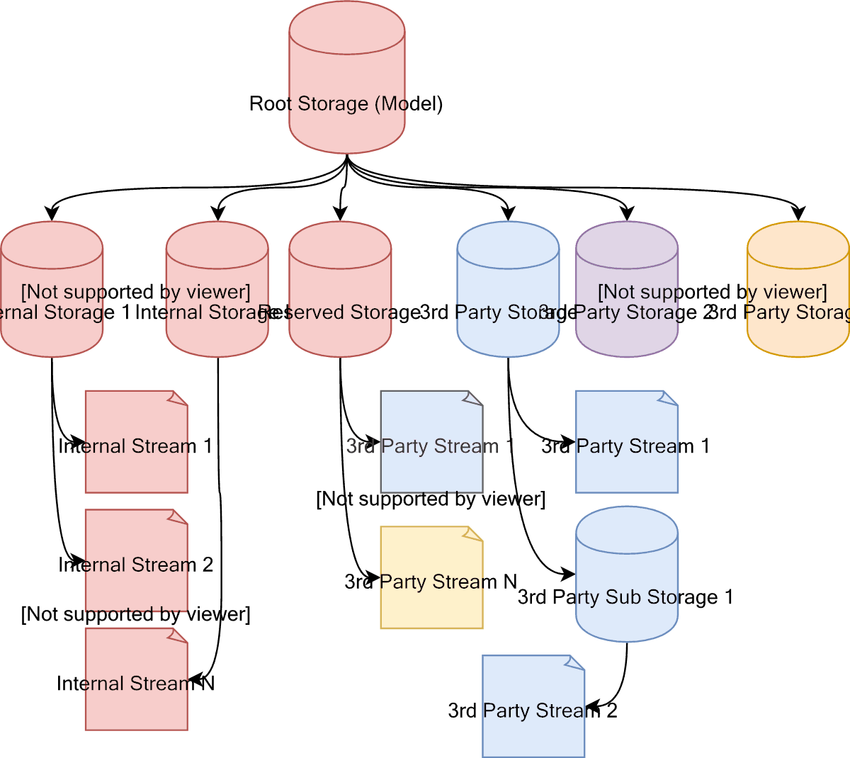

However, storing files separate from the model data doesn’t seem like a robust solution. So, with that said, using the 3rd party storage via the API may be the best way to store what you’re looking for without writing it all out in an annotation. This would require an interface for the user to access the data somehow too.
