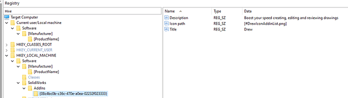

My installer registers all public classes in my add-in DLL. Only my add-in, plugin and TaskPaneWindow classes are public, the rest is internal. COM registration is only enabled for this one DLL. The only hardcoded GUID I have is on my add-in class, that’s the one that needs to stay the same between updates:

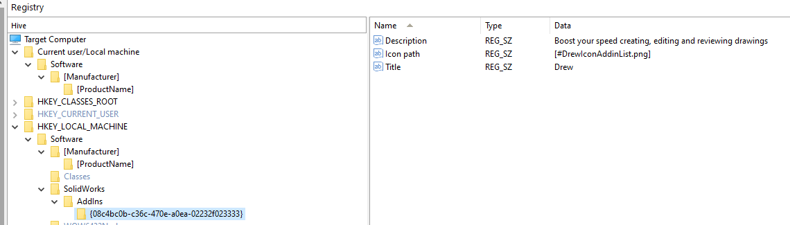

Register your add-in within the SolidWorks register
I add these registry keys for Drew so SolidWorks knows which class to instantiate during startup. Adding this key is why you need admin privileges to install add-ins:

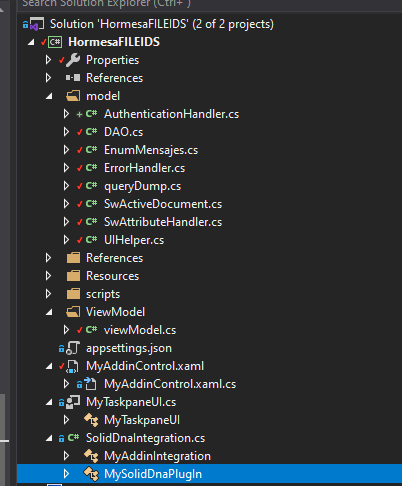

Hello Peter, i greatly appreciate your help. At this moment, the only machine that runs my add-in is the development machine. As i said before, i tried to use Visual Studio Setup Projects (herein VSSP) unsucessfully. Analyzing my dev machine registry, i saw some important things:
1- All my public classes were registered under “Classes” folder on HKEY_LOCAL_MACHINE_SOFTWARE/Classes.
Each class gets a CLSID apparently assigned by Visual Studio on compile time. I didn’t use an add in installer on this host/dev machine. I just used Luke’s add in registering tool and each time i compile, it reloads and works flawlessly.

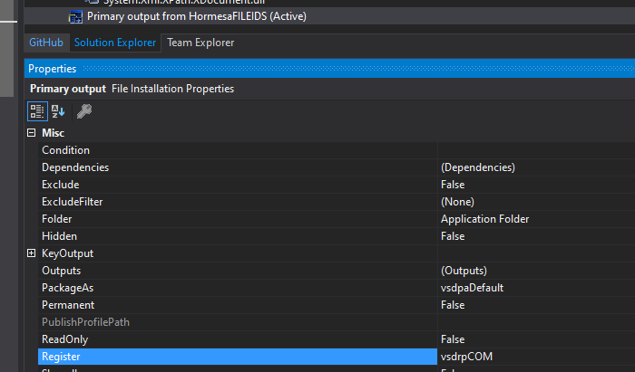

2- VSSP doesn’t register my classes for COM Interop although ive marked it explicitly, as shown:

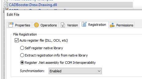

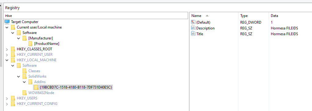

Since VSSP didn’t work at all, i decide to try advanced installer as you said, my registry page is this one:

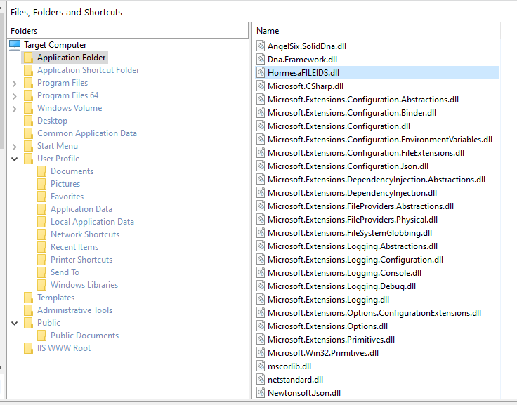

This is my build/resources list:
I find it rather weird on it including all microsoft dependencies. Smelly.

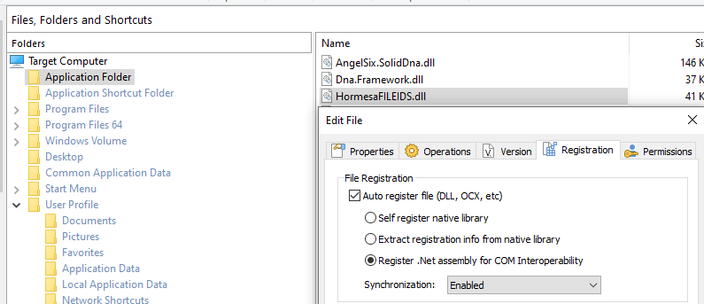

I have also set my output class to be COM interop registered, as follows:
All my classes are internal, bar MyAddInControl, MyTaskPaneUI and SolidDNA’s which are public This is taken straight from Luke’s WPF Addin template.

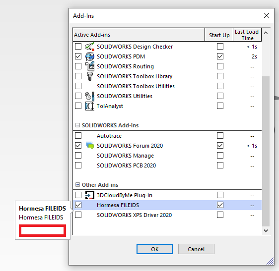

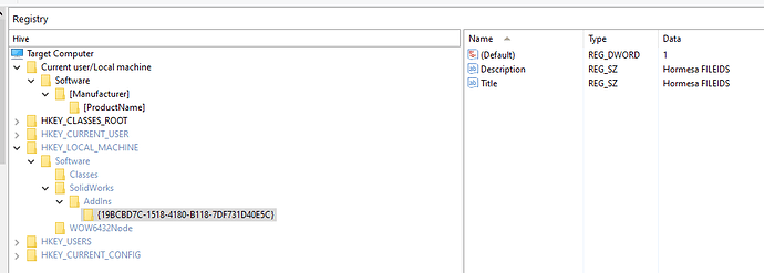

After installing with the advanced installer built installer, Registry shows the solidworks/addins key and all public classes registered with a CLSID under HKEY_LOCAL_MACHINE_SOFTWARE/Classes.
SolidWorks doesn’t give a d*** and add in simply wont load, path for the DLL is nowhere to be found, as shown here on the red square
Sorry for the long post, this is driving me to the edge, absurdly complex procedure for a trivial thing.
Your issue seems to be Registry related, not at all Solidworks related.

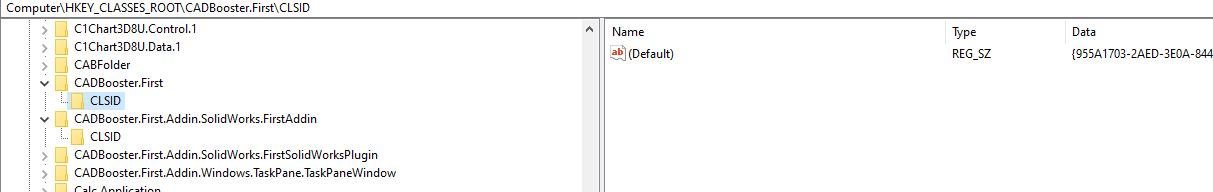

The CLSIDs of public classes are registered when you set Synchronization to enabled. Each public class should then appear in HKEY_CLASSES_ROOT. The top item CADBooster.First is the TaskPaneHost and uses the ProgID you set there. The three after that are my public classes.

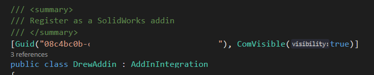

But even Advanced Installer does not run the code in classes marked as COM Visible / ComRegistration, so that’s why we need to add the GUID of the add-in to the Solidworks folder. The GUID you add to the add-ins folder in the registry is used to look up the add-in class. It should match the GUID on MyAddInIntegration.
I just looked up the WPF template you used, and the add-in class does not have a GUID attribute. Please add one, like this and add use the same GUID in the registry in the Solidworks folder.
So please check this:
  • Verify that each public class is under HKEY_CLASSES_ROOT
  • Verify that your add-in has a GUID “19BC…” or add one so it always stays the same.
  • Use the add-in GUID in the SW registry folder.
This was actually a big part of the issue that I was having. I placed my projects GUID in AddInIntegration class and that solved my biggest issue.

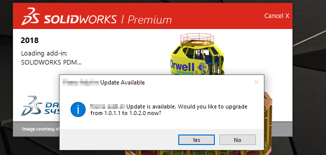

Got it working! Yes, it’s on another thread so loading the add-in isn’t significantly slowed. I just keep updating the MSI file in PDM and it will prompt the user to update.
Sweet! Is that inferno? :smiley: :fire: :fire: :fire_engine: :fire_engine: :fire: :fire:
Make sure you get the handle of the splash window so you can print the message box on top. There will be times where the message box prints below the splash and will cause people to think sw is not responsive.
