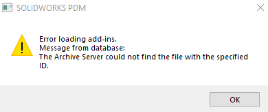

Here is the error message that the users of the problem sites are seeing.
The folder structure is there (Vault\0\plugins\000000##) on these 2 problem servers along with the index.xml file, however the ########.unk file that represents the add-in itself is not there.
