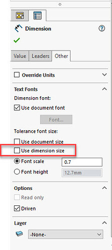

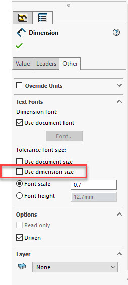

Hi guys,
does anyone know how to activate the checkbox in marked menu?
It is for dimensions with a tolerance, e.g. bilateral tolerance type.
the method just modifies the value but does not check the checkbox “use dimension size”:
