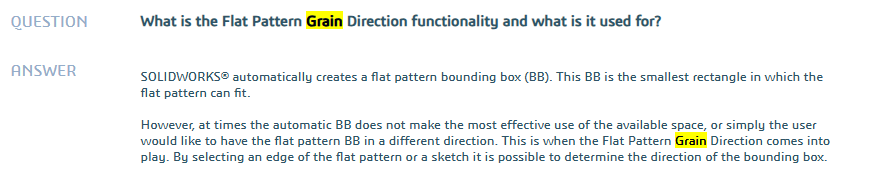

does anyone know if it is possible to retrieve the grain direction in a flat-pattern-feature?
Just did a quick search in the API docs. I thought IFlatPatternFeatureData would have something but apparently not.

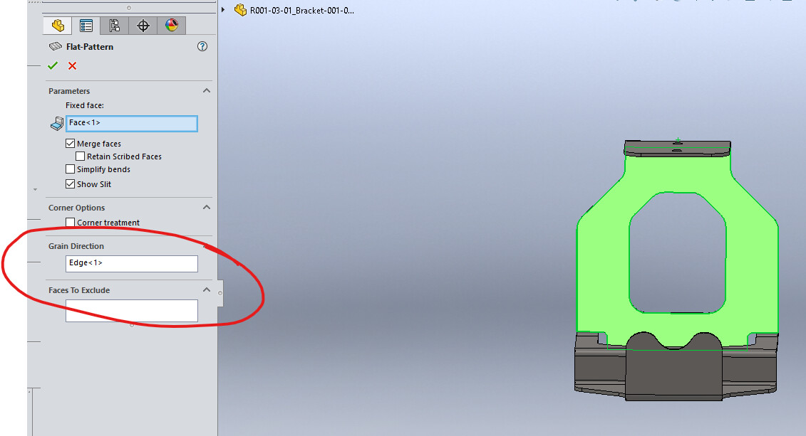

Your best bet is to open the PMP and make sure the grain selection box is highlighted some that you can get what edge or sketch line is selected with the the selection manager. I’m pretty sure the mark is 1 or 2 counting from the top of the PMP controls.
Hope this helps!
this is a great idea… i will try and let you know!
