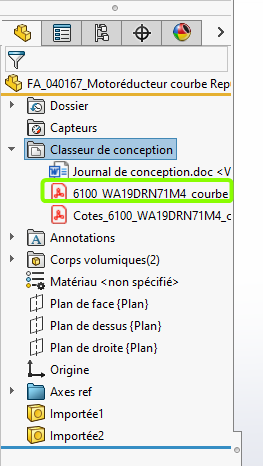

Hello,
In SolidWorks, I would like to Add a link file to Design Blinder and get the path (string) of a PDF file added into the design blinder as a link.
Is this possible in VBA? If so, do you know the function?

To Get link:
Dim swApp As SldWorks.SldWorks
Dim swModel As SldWorks.ModelDoc2
Dim swModExt As SldWorks.ModelDocExtension
Dim vOleObjs As Variant
Dim i As Integer
    Set swApp = Application.SldWorks
    Set swModel = swApp.ActiveDoc
    Set swModExt = swModel.Extension
    ' Récupère tous les objets OLE
    vOleObjs = swModExt.GetOLEObjects(swOleObjectOptions_GetAll)
    If IsEmpty(vOleObjs) Then
        Debug.Print "Aucun objet OLE trouvé"
        Exit Sub
    End If
    ' Parcours des objets
    For i = 0 To UBound(vOleObjs)
        Dim oleObj As Object
        Set oleObj = vOleObjs(i)
        ' Vérifie si c'est un objet lié (pas intégré)
        If oleObj.IsLinked Then
            Debug.Print "Lien trouvé : " & oleObj.fileName
        Else
            Debug.Print "Objet intégré (pas de lien externe)"
        End If
    Next i
